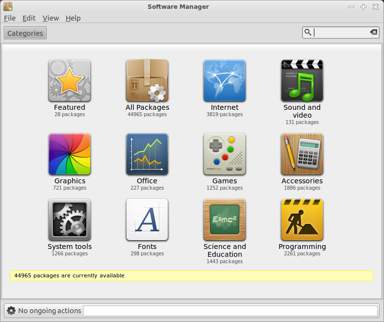

The Software Manager

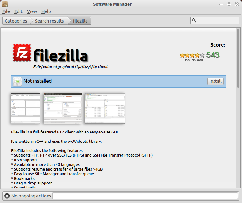

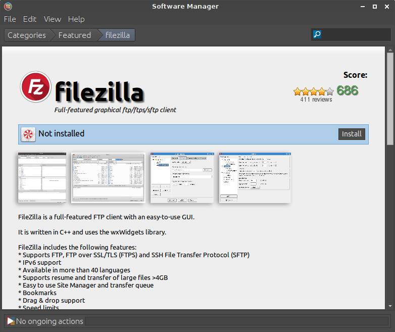

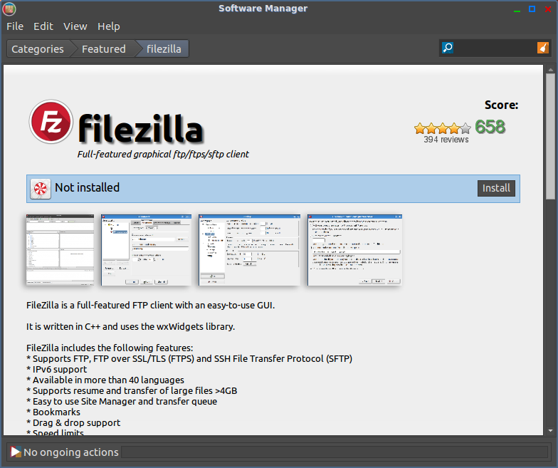

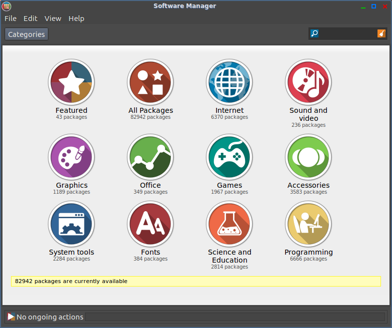

The preferred method of installing and removing software in Peppermint is by use of the Software Manager. This application was developed in house at Linux Mint specifically to offer a simple and intuitive means of managing software packages.
Here you will find software broken down into categories according to their intended use. You will also find descriptions, reviews, and ratings for each application. The most popular and highly rated applications can be found in the “Featured” category.
Using the Software Manager is quite easy: simply navigate to the application you wish to install and click on the “Install” button. That’s it. The Software Manager will handle all the rest for you, including dependency tracking. In a moment you should be able to check the menu and see your freshly installed application.
Removal of applications in the Software Manager is handled in exactly the same way except that you will see a “Remove” button for applications that are already installed on the system.

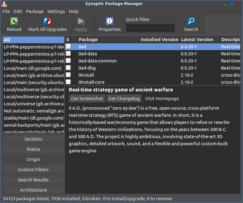

The Synaptic Package Manager
If you’re looking for something that’s a little more technical in nature than the Software Manager, the Synaptic Package Manager should fit the bill nicely. Synaptic can be easily be found in the “System Tools” section of the menu.
Synaptic makes very few compromises in the way of simplifying software installation the way the Software Manager does. As such it’s often the preferred graphical tool for veteran users and power users on systems where it is available. While using Synaptic, be prepared to have a good idea of exactly what you’re searching for as it is less discriminating about such things than the Software Manager.
Synaptic functions by having the user mark packages that they wish to install, upgrade, or remove. After all the changes you wish to make are marked, simply click on the “Apply” button. From here you will be prompted with a confirmation window that provides drop down menus which break down all of the changes to be made, including any dependencies that are necessary for the software you are installing. Clicking “Apply” in this window will confirm the changes and Synaptic will go ahead with the process.

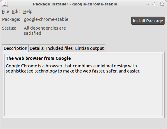

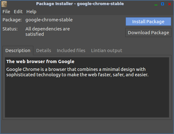

So what happens if you download a software package that isn’t available in the Software Manager or in Synaptic? Fortunately there’s a tool specifically for this job called GDebi, and it’s very easy to use. Double-clicking on a downloaded software package in the file manager will launch GDebi and it’ll present you with a simple, yet intuitive interface to work with. In this example I’ll be installing the unstable build of Google’s Chrome web browser.
Unlike the Software Manager and Synaptic, GDebi does not automatically handle dependencies for you. If a software package requires other packages to be installed first, it will let you know but you’ll need to find alternate means of installing the additional packages (such as the Software Manager or Synaptic).
Once you have installed the required dependencies via some other means, you are free to install the downloaded package with GDebi. The installation process should only take a few seconds and you’ll be shown a dialog box that indicates the installation status.

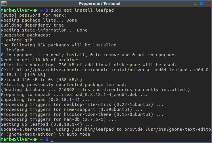

apt install

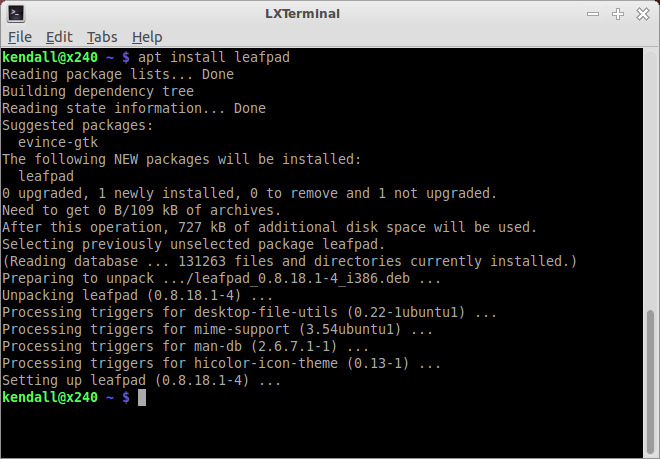

Now we get to the fun part. The “apt install” command will install any available package by including the package name after the command If you want to install the Leafpad text editor, then type “apt install leafpad”. If you want to install the Eclipse integrated developer environment, then type “apt install eclipse”. Applications like Leafpad, which has no additional dependencies, will simply download and install after you enter your password. Applications like Eclipse, which has a lot of dependencies, will prompt you for whether or not you want to install all of the required dependencies before moving forward. Software management from the terminal is generally much more efficient than going through one of the graphical tools. The downside is that you have to know the name of each package you wish to install.

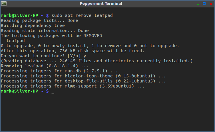

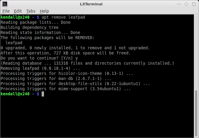

apt remove
Removing software is just the same as installing it except for one word. Just like with the “apt install” command, simply add the name of the application you wish to remove after the “apt remove” command and hit “Enter”. You may be prompted for your password, then the command will ask you to verify using “y” or “n” and if you select “y” then the application will be removed. Configuration files from the removed application will stay on the system in case you later decide to reinstall the application. There’s really not much to it.
apt purge
This command is just like “apt remove” however it will remove any configuration files associated with the application being removed as well.

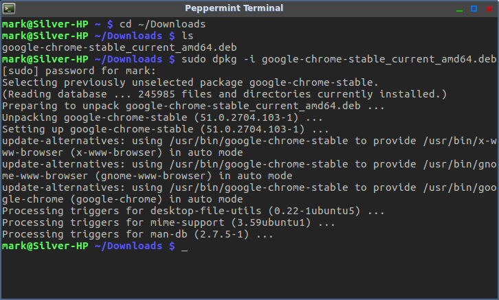

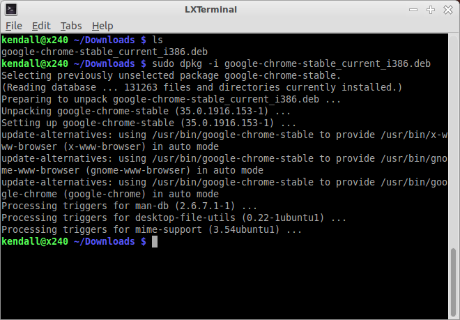

sudo dpkg -i
Just as GDebi handles downloaded software packages with a graphical front end, “sudo dpkg -i” handles downloaded software packages from the terminal. This command works in a similar manner to “apt install”, however it does require that the terminal be open to the directory where the package is, or that you type the full path to the software package. In addition, “sudo dpkg -i” requires that you type the entire filename (including the version and the .deb extension) of the software package whereas “apt install” simply requires the name. For example I’m going to reinstall the Google Chrome package I installed earlier with GDebi, but this time using “sudo dpkg -i”:
To break things down just a little bit, the “sudo” part of the command tells the system to use administrative privileges while running the rest of the command. “dpkg” is actually a very large and very powerful framework for working with Debian software packages in almost any capacity. The “-i” is simply one of the many options in “dpkg”, this one meaning that it should install something. Finally we have the full name of the downloaded software package. We can’t abbreviate here as is done with the “apt” commands as “apt” will always refer to either the most current version (when installing or upgrading) or the installed version (when removing. Many people use “dpkg” to work with older versions or experimental versions of software and in these situations typing the exact package name with the exact version number eliminates much confusion.
